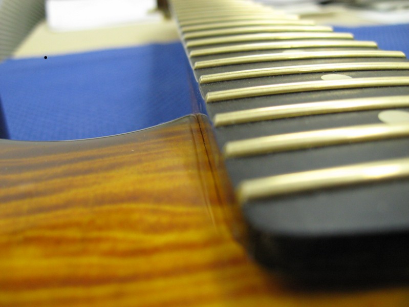

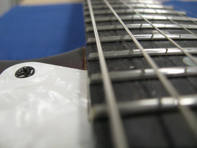

Got this awesome quarter sawn1-3/4 neck today but due to the fretwork I have to have it refretted before I can use it.
Fret beveling gone bad. 4 times the normal size than normal beveling!!!
Look at the image and you see why.

I can't see any problem - I'm about to take a neck in to get it beveled, they'll take off a bit more than your #2 picture.

It's the old neck that looks unusual to me. Those frets are practically square on the ends. The guy who'd have to clean those up would have had a lot more work than usual. The frets on the new one are cut in such a way that it won't take a week to smooth the bevels out. There should be about a 35 degree angle on the ends, which is what it looks like you got on the new neck.

Yes - it is the old one that has issues.

Looks very nicely done to me.... unless the e's slip off...

Yeah the E`s are going to slip of for sure and that's my only concern !
The reason I ordered this wide neck was that I wanted a lot width for the E strings to not slip off.
I have two vintage Fenders and they are more like my old Warmoth's
I don't see the reason why it should be 35 degrees, to me that is overkill.
10 - 15 degrees beveling is enough and you get more fret to play on.

That second photo mimics the bevel on my W necks. My E's don't slip. Try it out first before deciding for a re-fret. It COULD work fine!

I think the Es slipping off is more a function of the string spacing at the bridge than the fret bevel. The only guitar I have that I really ever slip the E off of has a wide fender vintage spacing (2 7/32 I think) and the fret bevel is less severe than my others (I had them done at a different shop). I prefer the more extreme bevel and a bridge spacing of 2 1/8 or 2 1/16 like most newer guitars. A wider nut is generally only good for thick fingers or all-fingerstyle people - and it should not have too much to do with the high E slippage problem.

+1 to all of this. i would assemble it before i spent the money to have that work done. you might be very surprised. i doubt you'd be getting TOO close to the edge of the fretboard with the high E anyway, unless you pull down instead of push up when you vibrato or something. anyway try it out first, you might be surprised.

"Fret edges are back-beveled to about 30°. By special request we can leave this edge square."
I never requested that they should make them like the top one in the second image!
I have two Warmoths like that and they are perfect in every way.
I always thought that, that was standard plus my brother has a couple of Warmoths too that have the same beveling as the top one in the second image!

Have you ever had the frets on those other guitars professionally finished? You might have found that they'd have knocked the bevel back and polished it smooth. Warmoth, by their own admission, does not finish or polish their frets. They more or less just install, level and dress them, which amounts to a lick and a promise. Many people leave them at that because newly installed and dressed frets are often pretty level and don't need a great deal of attention. But, you can't really completely finish a neck and fret job without installing it and putting it under tension, so they don't.
Seriously - spend the money with a good luthier and have those frets properly finished before you start yanking them out and replacing them. It'll cost you a lot less and I'll bet you'll be glad you did it.

I just checked my W neck. it's a bout 30% on the bass side, 15% on the treble side, and no I haven't (probably never will) had them finished or polished.
