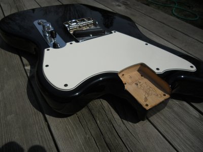

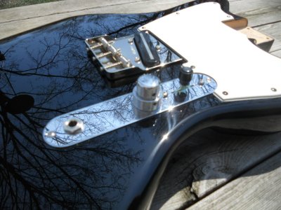

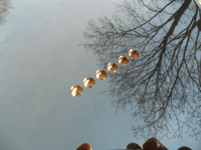

Parts arrived Friday afternoon while I was at work, then Saturday I spent the day with family, but now it's guitar-time! Body and components went together in a jif with only one unresolved hang-up:  the installation of the string ferrules. I heated them with a soldering iron (a tip from you guys) and pressed them into the W-drilled holes. they slid in like a champ... -too far! they are completely submerged to the bottom of the hole; once I got passed the top finish, there was nothing to keep them from sliding all the way in. -I think I can get 'em out, but the flush-mount vintage style ferrules I ordered are not going to work with how deep W drills the 5/16" portion of the hole.  :-\

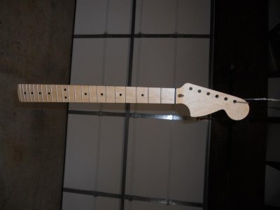

Neck has started getting coats of Minwax satin poly after getting the edges knocked down a bit on the headstock and the fretboard's treble-side. Should be ready for final assembly next weekend(?), with only one concern left (other than those string ferrules):  pressing in the tuner bushings. I ordered some Kluson-style tuners with Gibby-style keystone buttons, and the bushings seem wider than the ones I've worked with before. I'm a bit reluctant to just start pressing them in without some wood removal (-slightly enlarging the reams), but I lack a drill-press, so...

That black looks really deep judging by the reflections.
A reamer might be a better tool for the tuner holes or improvise with sandpaper around something round and solid.
Thanks, stratamania. You're right; best to stay away from powered tools so I can keep the progress (and mistakes) slow and gradual.  :icon_thumright:
That shot of the rear string ferrules had me wondering what the hell I was looking at for a minute there. The finish is so flat, it looks like a shot of the sky with some strange balloons floating up in a line  :icon_biggrin:
Some hardware you gotta watch close. It's funny how often they don't tell you some critical details. If you happen to find what appears to be a great deal on something, it may be that it's metric and they leave that detail out. The Kluson-style tuners Warmoth sells are made by Gotoh, and their ferrules require an 11/32" (.343") hole. Warmoth calls that their "vintage" ream. So, I'd put a caliper on the OD of the parts you've got and see where they're at. It may be that the holes in the headstock are the right diameter, but there's a bit of a lip from the finish making them seem smaller.
If it's just a finish lip, I wouldn't take a reamer after them. Liable to chip the paint. Sanding is more forgiving.
They seemed too tight without finish. -And that's what I mean; the other ones I put in were either from W or the Fender-brand "vintage" tuners... and those didn't just slide right in there, either, but these seem like they could split the wood if i started to crank down on 'em to cram 'em in the existing ream as-is. Dunno if it was an intentional bait-n-switch, but the site I got 'em from called 'em Gotoh's, but they arrived in that god-awful Allparts shrink-wrap pkg.; -maybe it's just one company making them all, and whatever package they come in is just a matter of which private-label inventory is in surplus at the moment.  :dontknow:
Had a lull in applying coats of poly to the neck, so I worked on fitting the bushings to the headstock. A bit of sanding the reams did the trick; I think they'll scootch in there with a moderate amount persuasion.  :icon_thumright:
