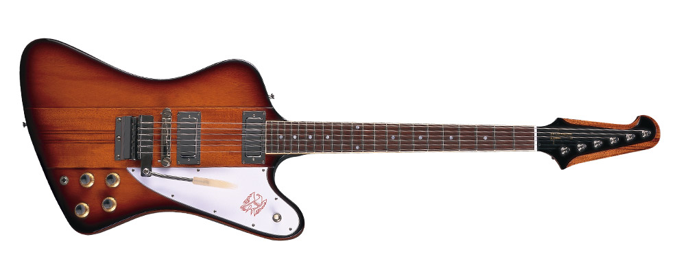

Burst over mahog?
Any burst Firechicken (Firebird) will do... well, the wings at least:
Link to Black+Yellow burst Firebird - http://www2.gibson.com/Products/Electric-Guitars/Firebird/Gibson-USA/Firebird-V.aspx
Here are some bursty Carvins with mahogany, to give some well-photographed examples of what can be done with that wood:
These images suggest that (if you aren't going to bleach the mahogany so it'll take a yellow well) that perhaps a dark red or black burst edge is the way to go, if you want to go burst-ward.
