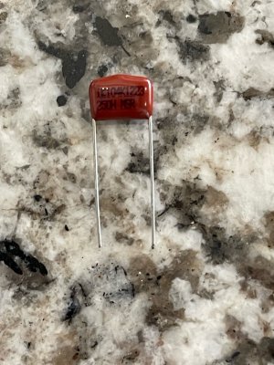

GuitarMadCap Junior Member Messages 49 Feb 24, 2024 #1 Is there a way to tell what type of capacitor this is by its markings? Attachments image0.jpeg 489.5 KB · Views: 12
somebodyelseuk Junior Member Messages 60 Feb 24, 2024 #2 Yes. I used to have a link to a page that explained what the numbers mean... you'll have to Google it - 'capacitor codes' or something like that.
GuitarMadCap Junior Member Messages 49 Feb 24, 2024 #4 I‘m pretty sure it’s a Fender 1uF cap for a treble bleed.
somebodyelseuk Junior Member Messages 60 Feb 24, 2024 #5 I didn't want to commit to it, but I did think it might be a 0.1uF cap... wouldn't bet my coffee on it, though.
mayfly Epic Member Messages 8,737 Feb 24, 2024 #6 The critical part of the number is '104', which means, 10 with 4 zeros behind it in pf. That is 100,000pf, which translates into 100nf, or 0.1uf.
