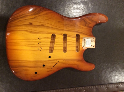

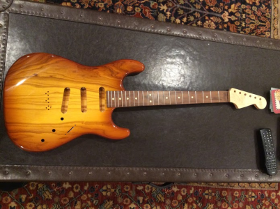

Strat Build - Swamp Ash Hardtail
CrackedPepper
956
Showcase body Specs:
Swamp Ash
Honey Burst Finish
EMG Control Routes
7/8" side Jack
Neck:
Strat Modern
Pau Ferro on Maple
Clear Satin
59 Roundback contour

That is one beautiful  :glasses9: piece of Ash ya' got there CP
Plus a Hardtail with a 59 Roundback neck :icon_thumright:
You can just finish that girl on up and ship her home to me...
:kewlpics:
Actually, I have a set of Cream colored Seymour Duncan Stacks that I am going to put in there:
Vintage Hot Stack Neck Pickup
Classic Stack Plus Middle Pickup
Custom Stack Plus Bridge Pickup
I had a feeling as soon as I asked about EMGs they would be something else that fits that rout. Much neater I think than the standard Strat shape in a top rout. Cream should go well.
Yes, I don't like the route to accommodate the flat work on regular Strat pickups.  I looked to see if the dimensions for EMG would accommodate a pickup with a similar profile. Luckily, SD Stacks have just about the same footprint and I like the way they sound.  Just have to figure out how to mount them.
