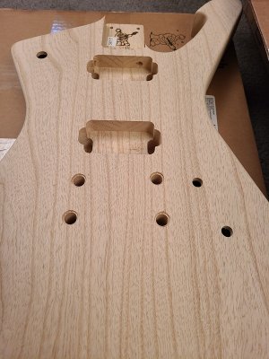

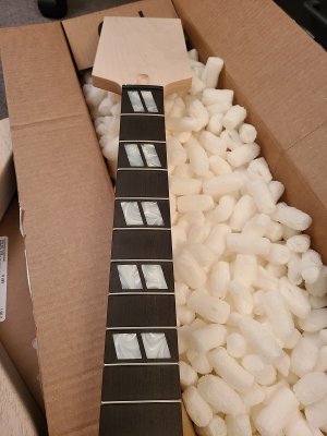

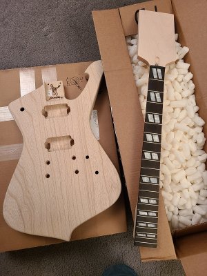

Swamp ash body, maple neck with ebony fretboard, split block pearloid inlay and tiltback paddle headstock for another custom-cut headstock.
This is for my best friend, who's a big Mopar guy, so the inlay was tribute to the Dodge racing aesthetic.  The body will be some variation of purple (to match his Challenger).  I ordered black hardware from WM as well (tuning machines, TOM/STP bridge, strap buttons).

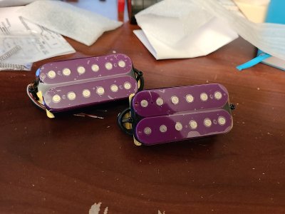

Finally, purple Dragonfire humbuckers.

Loooookingggg Gooooood! I can see all kinds of possibilities there............. :headbang:
Yeah, I'm really impressed with the body. I know it's a two-piece since I can see the seam and the grain difference when I look down from the neck pocket, but they did a really great job matching the grain figure on the main part of the body, below the bridge.  I can barely see the grain pattern difference in that area.

That's some seriously good looking Swamp Ash! I love that figure!
Congrats - keep us posted on your progress - I love purple - so this should be a super cool project!!!
