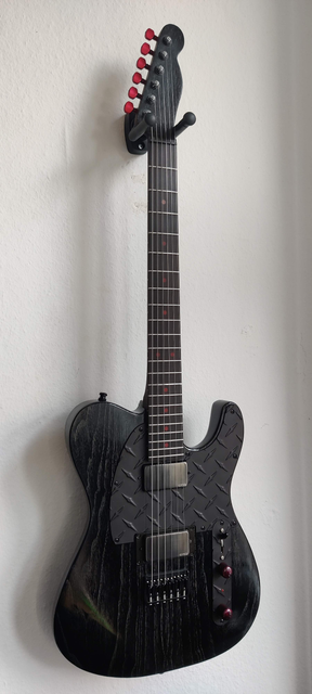

The "Blood Stain" Tele
alexreinhold
647
Build thread link: https://www.unofficialwarmoth.com/index.php?topic=33831.0
Specifications:
Non-Chambered Warmoth HH Telecaster Replacement body
- Mahogany core, Swamp Ash top
- owner-finished (wire-brush Ceruse method) with Talens India Ink, Silver glaze, Chestnut Sanding Sealer and Tru-Oil, TRVE logo with Fluids Alcohol Ink “Bloody Mary”
Unfinished Warmoth Telecaster Replacement neck
- Shaft wood: Wenge
- Fretboard wood: Ebony
- Scale: Gibson scale conversion (24 3/4)
- Standard thin, 12-16” compound radius
- Frets: 6115 stainless steel, 22 frets
- Inlays: Bloody Basin Jasper[/list]
Hardware:
- Bridge: Hipshot Contour
- Tuners: Sperzel EZ Mount
- Pickups: EMG 81 bridge, EMG 60 neck
- Pots: 1 Volume, 1 Tone

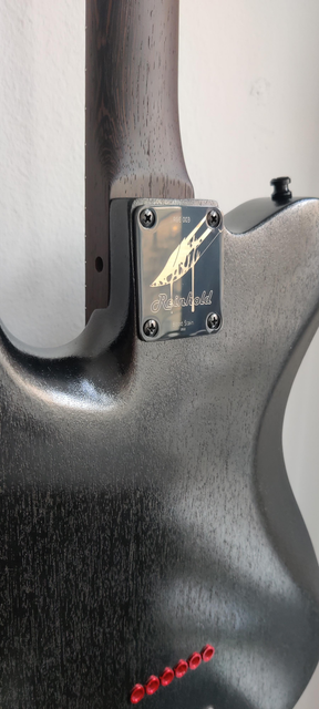

- Neck plate: custom laser-engraved from TLC Guitar Goods (Netherlands)
- Active Pickup Power Supply: double-battery box
- Knobs: Xentric Autumn Pearl dome knobs
- Ferrules: Forney Custom Colorbrite
- Battery Indicator: GuitarElectronics Lo-Bat Indicator
Wiring: 3-way HH, 18V Mod, Battery Indicator LED light
1. Bridge
2. Bridge and Neck
3. Neck
Photos:

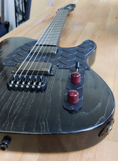

Look close - it's TRVE:

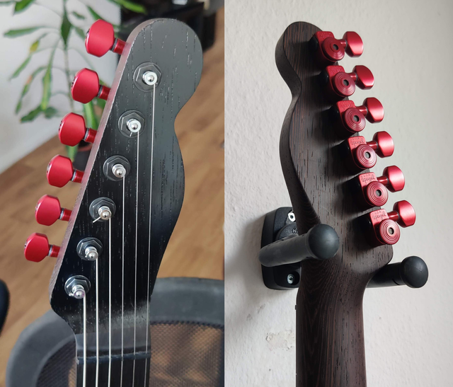

wow!  that looks great.  Too bad about the tuners - watch those custom buttons!
:headbang:
:headbang:
Thanks a lot Mayfly. Turns out sperzel will actually send a new tuner. Until then the super glue must hold haha

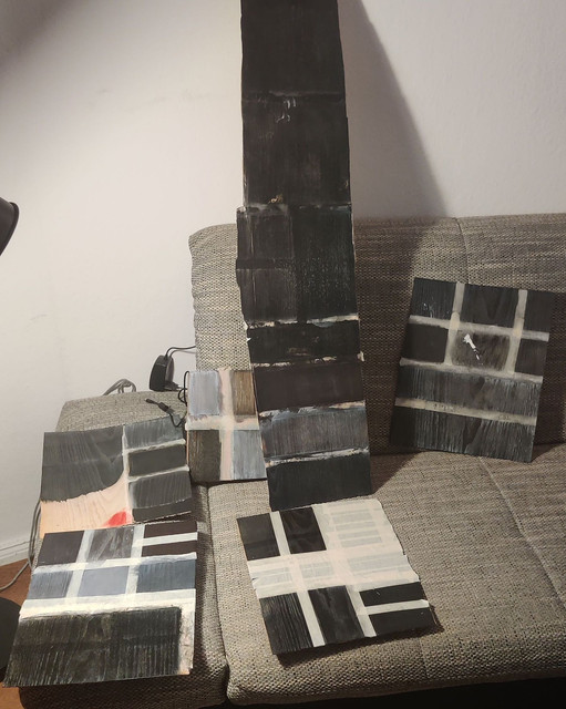

Thanks Seb. I think it was actually one of your builds that made me aware of how cool a doghair can look like (you had it on a mahogany back, right?). I learned quite a bit throughout the process - e.g. a) there are several ways to skin this cat, b) one is using several different products and the slightest incompatibility can ruin everything (and in my case most tutorials were from the US and we have very different brands for finishing products in the EU), c) it appears to really only work with very open pore woods like ash, oak or mahogany - my Zebrano experiment failed badly.
Here's an insight into all my trials/errors:
Awesome job! And the finish test pieces kind of look like trendy modern art pieces; you should hang them on the wall lol
alexreinhold said:
lol true. Hipster art galore
Nice to see your process! Some of my tests have lived on to become coasters etc :), one of course was my pedalboard.
