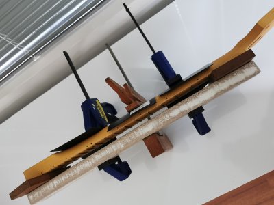

A good neck but maxed out to further reduce the relief.  Still playable but with no more leeway to adjust it perfectly straight. Also shipping it back to Warmoth is a hassle for me geographically. I am currently trying out this perhaps to condition the wood.  Looks like it's working....

I have seen You Tube repairers loosen off any tension from the truss rod & then place the neck into a press using weights and/or vice. Like you have shown.
Get it as flat as you can then add any trussrod tension. Gotta be patient, this won't be an overnight fix.
I had a fender neck like that.  Loosened it.  Put it between two boxes with weights in the middle.  Let it sit for a month.  Solved problem.

Having worked with wood for a long time, I always believe that it changes to environment. The wood fibers are trainable even if they inherently go a certain way even after dried and treated. The neck that I received was inherently bent and maximum trussrod adjustment will not bring it to be completely straight. The factory must have known this and hence stacked up the washers in hope to create more thread turns. My attempt now is to "retrain" the neck wood to "environmentally" straighten over time.  Seems to be working but I will give it a few more weeks to condition.

In my experience wood has a memory. That memory can be modified, sometimes for the long term, sometimes just temporarily. I think your doing the best you can do right now, in time it will either change or it won't. You never fully know for sure till you try. That method, sometimes augmented with heat, is more or less the most popular traditional method. Good luck on it. Patience is the key, the only thing that wood does quickly is break..... :eek:.. :headbang:
