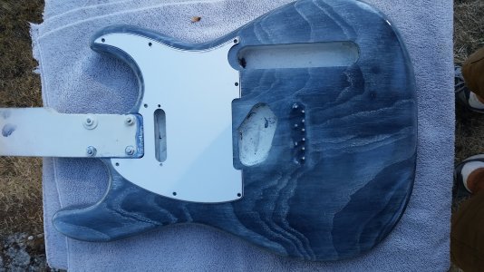

I used white pickling gel stain for the grain fill on this "reiteration" of my hybrid I've been torturing and learning on.......
Added in EDIT: The back side looks better, I think, but I don't have a pic of it on my laptop here. Also, Timbermate "Natural" is a good white grain filler I personally like to use.
Thanks, Mr. N. That one does bring out the grain nicely. I'll definitely give the grain fill a test.
