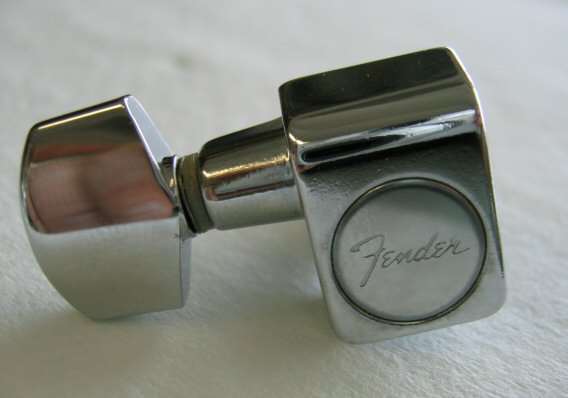

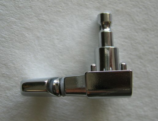

And here's the tuner type:
I have a drill press and ultimately can resolve any hole size problems, but (for tuners especially) i'd prefer the accuracy of CNC if it's an option.
Those are Schaller Original F-Series Standard tuners, private labelled for Fender. The shaft housing diameter is 10mm.
Note that Warmoth will drill for those shafts so you get a nice, tight fit, but you'll still have to drill for the locator pins.
Was just jumping in here to say this. Not sure what Fender's obsession with locater pins is, but they use them on their tuners and string trees. Drives me nuts.
The best way to do it is insert the tuners into the tuner holes, make sure they're aligned correctly, and then give 'em a good solid push (or maybe insert the bushings/nuts and tighten them a bit) so that the locater pins leave two dimples in the back of the neck, revealing their precise placement. Then it's an easy matter to drill for them.
