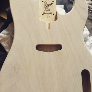

So I have a can of white stain but I want to bring the grain out more. Would there be any ill effects of using a black grain filler first? Haven't ever filled grain before.
I use a lotta blue painter's masking tape. It has a lower-tack adhesive than standard masking tape to it's less likely to harm finishes or leave residue. That said, no matter what tape you use it's going to leave residue. How much it leaves is usually proportional to it's starting point and how long it stays in place. The blue stuff has a very low starting point, so it would seem to come off clean, but even that will leave noticeable traces if you leave it on for days on end. On the plus side, it's usually not detrimental and is easily cleaned up with naphtha.
There are no negative effects from using grain filler, tinted or otherwise.

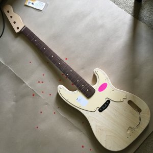

People. Minwax' Marshmallow stain is a surprisingly close approximation to Fender's transparent blonde! The camera+lighting are adding some goldish tones to the color; it is actually much paler than shown.

I want to use the vintage thumbrest. Would you people recommend drilling thru pickguard and body simultaneous? Drill thru pickguard from bottom?
If you're happy with the pickguard placement and it's screwed in so it won't move, then yeah. Drill it in place. Do one hole and run the screw in through the thumbrest so it won't move, then position it at an angle you're comfy with and drill the other.
