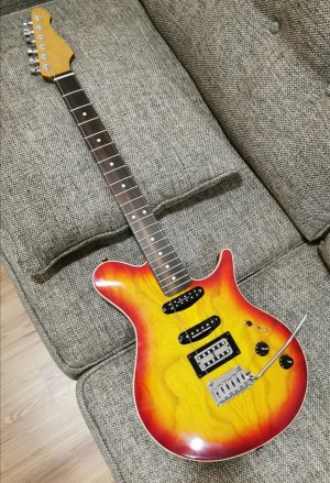

Mine has a trem so that acts as a good counterweight with a roasted Maple/Rosewood mounted.  Having said that, the Velocity is very well balanced on it's own. The upper horn extends quite far out and the lower bout of the body is quite wide. Even if you put a string-thru hardtail bridge, the balance will maintain with a Maple neck.  However, solid Rosewood necks may tilt the balance slightly mounted with heavy tuners.
Good to know! Mine would have a trem, and most likely a roasted maple neck/rosewood board. Tuners would be Hipshot open locking, which aren't as heavy as closed locking Schallers.
BTW, cool guitar, with very awesome pickups!
Very cool guitar.  I have an all mahogany Velocity body scheduled to arrive Friday, to be mated with a 24.75" tiltback Strat roasted maple / ebony conversion neck.  Your pic is not helping me with my "waiting like a kid the night before Christmas for Santa to arrive" factor.
