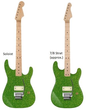

For my next Warmoth, I'd like to do a 24.75" scale 1H, inspired by Charvel custom shops.  I'd prefer 24 frets with a Strat headstock, but such a thing isn't offered in this scale length.  For the Soloist, I like the Strat headstock, but not keen on the non-traditional body and lack of 24 fret option.  For the 7/8, I like the traditional body shape and 24 frets, but not fond of the headstock.
As a side note, I really wish Warmoth would offer this lime green in a metallic paint instead of flake, but oh well.
Which one would you build?

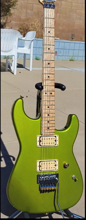

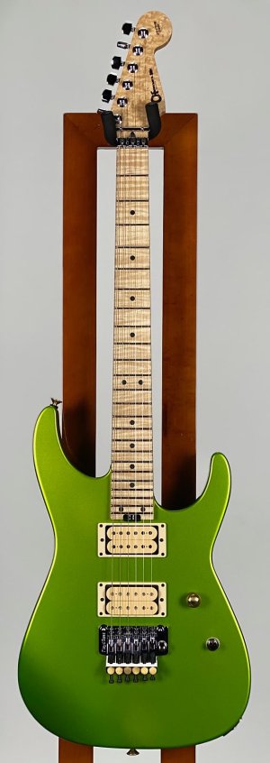

I suppose “shredder” wasn’t a good descriptor for wheat I’m building since I’m no shredder. Van Halen is about my limit. I was inspired by this Charvel “strat” body, then found they did a similar soloist-style too.
And it also seems there’s a third option — Soloist body with 7/8 neck (off-menu option). Very cool!

I'd like to see an overlay of 7/8 Strat vs 7/8 Soloist to understand how it will affect the layout and balance of the guitar.
