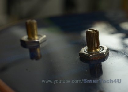

Use one of the longer bushing pots to fit through a rear route, and put the flat washer that will come with it between the top retainer nut and the finish. The star/lock washer will go underneath between the pot body and the top, as shown here...

Thanks, Any chance you could take a photograph of the the lower most pot with out the knob?
Mine is an older soloist carve which had quite a deep carve, is this the same?
One side of the pot hole is easily 1mm higher than the other, so I'm trying to work out how that works as the hole is goes straight down. How does the washer sit down flat on the top?
