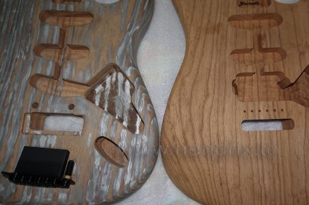

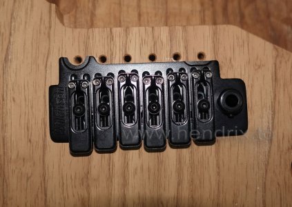

I happen to be have both Wilkinson and  Vintage 6 Hole body in hand , you can see  Wilkinson rout is bigger , but that because it can pull and push much more than Vintage one ,  it can pop  into  6 Hole routing , but just being able to only push down not pull up like  Vintage 6 Hole .
only need to drill those 2 hole for the stud install .
