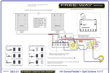

This gets you everything you want plus extra.  I love the in series out of phase setting.  I have a better copy if you want me to email it to you.

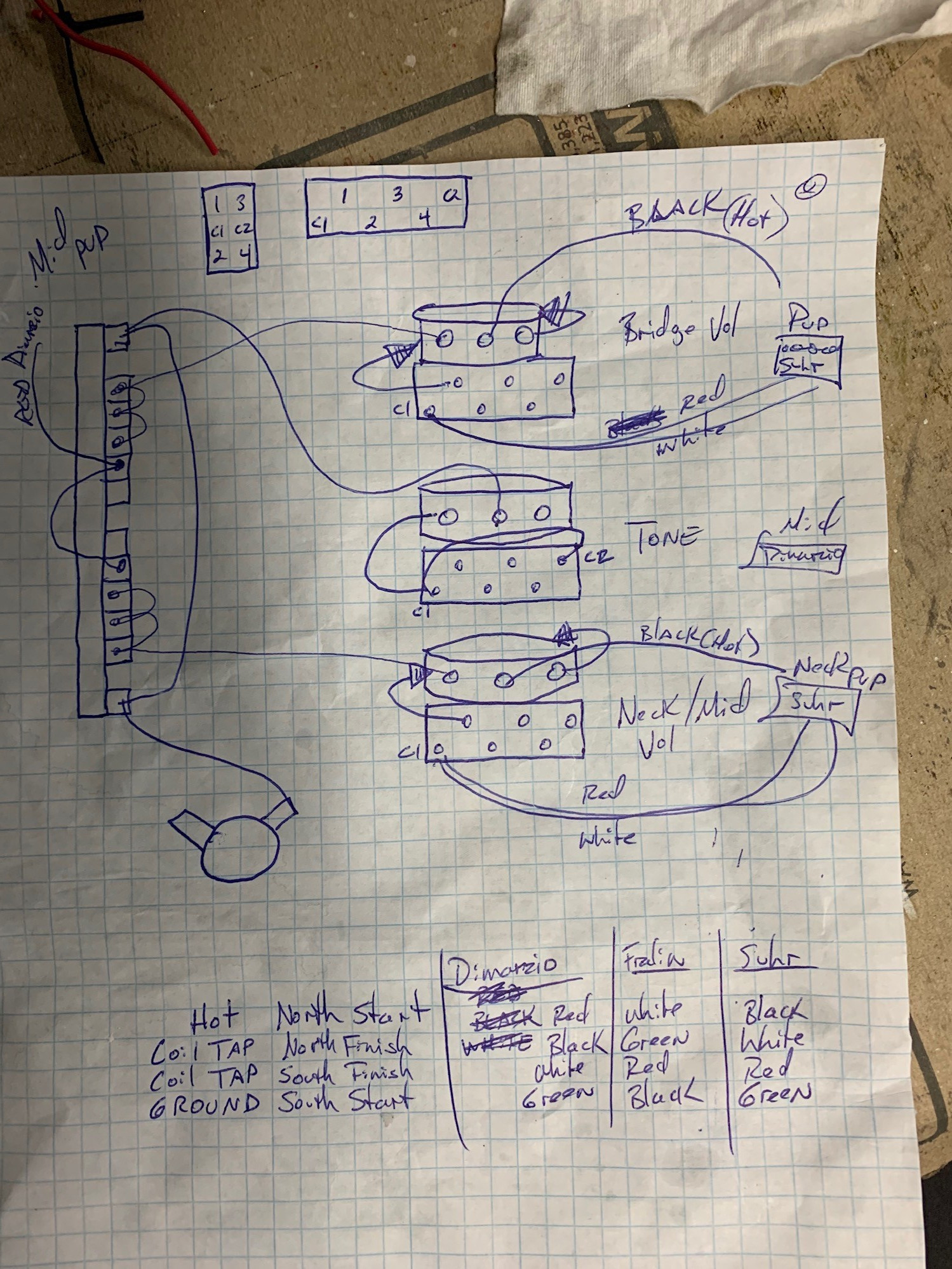

If it helps, I just did this in my build.
Controls...
Pot 1 (closest to bridge ) = Bridge Vol / Pull up to split to single coil - In the wiring diagram, coming off the "1", I'm using a 6.8k resistor to boost the output of the SC sound a bit, which then goes to ground
Pot 2 = Ton / Pull up to switch from .047 to .022 tone cap (I may try something else here, as there's not much of a tonal difference when the tone is on 10) - Not seen in the wiring diagram, coming off of the "4", I'm using a .047 cap, and grounding it, coming off the "3", I'm using a .022 cap and grounding it
Pot 3 = Neck Vol / pull to split to single coil- In the wiring diagram, coming off the "1", I'm using a 6.8k resistor to boost the output of the SC sound a bit, which goes to ground
5 way switch (using 2 pole Super Switch, or half Super Switch)
1 - Bridge (hb or sc)
2 - Bridge / Middle (can use bridge hb or sc), also if I dump the Bridge vol, i get pure middle pup tone, however there is no volume control for the middle
3 - Bridge / Neck (This seems to be the magic zone.  Can get 4 different parallel tones here)
    Bridge HB / Neck HB
    Bridge SC / Neck HB
    Bridge HB / Neck SC
    Bridge SC / Neck SC (does a really nice version of the Tele in between sound)
4 - Mid / Neck (can use neck hb or sc), if I dump the Neck vol, i get pure middle pup tone, however there is no volume control for the middle
5 - Neck (hb or sc)
